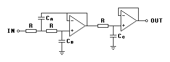

HwB: Active Filter: Butterworth 18dB Lowpass
![GoTo Circuit](mini_Back.gif)
![CIRCUIT](menu_Circuit.gif)
![GoTo Main](mini_HwB.gif)
(3st order, 18 dB/octave, Lowpass)
![3st order Butterworth Highpass](cir_ActiveFilter3L.gif)
R=4.7k-10 kOhm
Ca=2.000/(2*pi*Fc*R)
Cb=0.500/(2*pi*Fc*R)
Cc=1.000/(2*pi*Fc*R)
Units: R [Ohm], Cx [F], Fc [Hz]
