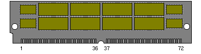

HwB: 72 pin ECC SIMM Connector
72 pin ECC SIMM
SIMM=Single Inline Memory Module
ECC=Error Correcting Code.
(At the computer)
72 PIN SIMM at the computer.
| Pin | ECC | Optimized | Description |
