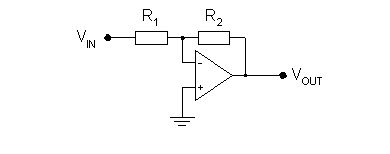

Operation Amplifier: Inverting Amplifier
VOUT= -(R2/R1)*VIN
The signal is inverted with this design (notice the minus sign
in the formula). But it's very easy to change the gain with the
help of R2.
