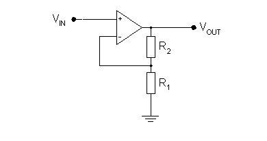

Operation Amplifier: Non-inverting Amplifier
VOUT= (1+R1/R2)*VIN
One positive effect with this design is that the signal isn't
inverted. But you can't have less gain than 1 times the
in-signal.
