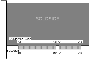

ISA
ISA=Industry Standard Architecture
(at the card)
(at the computer)
62+36 PIN EDGE CONNECTOR MALE at the card.
62+36 PIN EDGE CONNECTOR FEMALE at the computer.

Note: Direction is Motherboard relative ISA-Cards.
Note: B8 was /CARD SLCDTD on the XT. Card selected, activated by cards in XT's slot J8
