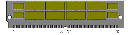

72 pin SIMM
SIMM=Single Inline Memory Module
(at the computer)
72 PIN SIMM at the computer.
