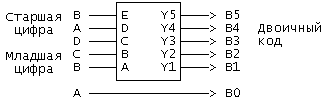

Преобразователь 6-битового двоично-десятичного кода в двоичный микросхемой 155ПР6 (184)
    В Х О Д Ы  В Ы Х О Д Ы
Число E C D B A -G Y5 Y4 Y3 Y2 Y1
 0-1 L L L L L  L L  L  L  L  L
 2-3 L L L L H  L L  L  L  L  H
 4-5 L L L H L  L L  L  L  H  L
 6-7 L L L H H  L L  L  L  H  H
 8-9 L L H L L  L L  L  H  L  L
10-11 L H L L L  L L  L  H  L  H
12-13 L H L L H  L L  L  H  H  L
14-15 L H L H L  L L  L  H  H  H
16-17 L H L H H  L L  H  L  L  L
18-19 L H H L L  L L  H  L  L  H
20-21 H L L L L  L L  H  L  H  L
22-23 H L L L H  L L  H  L  H  H
24-25 H L L H L  L L  H  H  L  L
26-27 H L L H H  L L  H  H  L  H
28-29 H L H L L  L L  H  H  H  L
30-31 H H L L L  L L  H  H  H  H
32-33 H H L L H  L H  L  L  L  L
34-35 H H L H L  L H  L  L  L  H
36-37 H H L H H  L H  L  L  H  L
38-39 H H H L L  L H  L  L  H  H
  X  X X X X X  H H  H  H  H  H

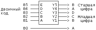

Преобразователь 6-битового двоичного кода в двоично-десятичный микросхемой 155ПР7 (185)
Число E C D B A -G Y8 Y7 Y6 Y5 Y4 Y3 Y2 Y1
 0-1 L L L L L  L H  H  L  L  L  L  L  L
 2-3 L L L L H  L H  H  L  L  L  L  L  H
 4-5 L L L H L  L H  H  L  L  L  L  H  L
 6-7 L L L H H  L H  H  L  L  L  L  H  H
 8-9 L L H L L  L H  H  L  L  L  H  L  L
10-11 L L H L H  L H  H  L  L  H  L  L  L
12-13 L L H H L  L H  H  L  L  H  L  L  H
14-15 L L H H H  L H  H  L  L  H  L  H  L
16-17 L H L L L  L H  H  L  L  H  L  H  H
18-19 L H L L H  L H  H  L  L  H  H  L  L
20-21 L H L H L  L H  H  L  H  L  L  L  L
22-23 L H L H H  L H  H  L  H  L  L  L  H
24-25 L H H L L  L H  H  L  H  L  L  H  L
26-27 L H H L H  L H  H  L  H  L  L  H  H
28-29 L H H H L  L H  H  L  H  L  H  L  L
30-31 L H H H H  L H  H  L  H  H  L  L  L
32-33 H L L L L  L H  H  L  H  H  L  L  H
34-35 H L L L H  L H  H  L  H  H  L  H  L
36-37 H L L H L  L H  H  L  H  H  L  H  H
38-39 H L L H H  L H  H  L  H  H  H  L  L
40-41 H L H L L  L H  H  H  L  L  L  L  L
42-43 H L H L H  L H  H  H  L  L  L  L  H
44-45 H L H H L  L H  H  H  L  L  L  H  L
46-47 H L H H H  L H  H  H  L  L  L  H  H
48-49 H H L L L  L H  H  H  L  L  H  L  L
50-51 H H L L H  L H  H  H  L  H  L  L  L
52-53 H H L H L  L H  H  H  L  H  L  L  H
54-55 H H L H H  L H  H  H  L  H  L  H  L
56-57 H H H L L  L H  H  H  L  H  L  H  H
58-59 H H H L H  L H  H  H  L  H  H  L  L
60-61 H H H H L  L H  H  H  H  L  L  L  L
62-63 H H H H H  L H  H  H  H  L  L  L  H
  X X X X X X  H H  H  H  H  H  H  H  H
