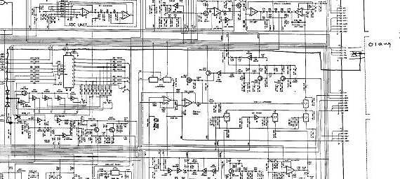

Модификация гетеродинного фильтра трансивера ICOM-765, выполненная радиолюбителем
SM0EBP, Боргом.
Subject: Re: IC-765 mods
Hello agn, Serge!
Let's se how it works this way!
Here is my text from 1989:
The IC 765 is a fine radio. Unfortunately we miss the old fine
passband-tuning.
IF-shift of course is also nice; but PBT better.
How abt getting both!?
Here comes a little easy mod that will give u IF-shift when the
IF-shift-button is IN and PBT when it is OUT!
You have to get to the PC-board at the underside of the radio.
Locate the brown wire going to base of Q38, cut that lead and insert a
diode
in series.
Locate the multi-connector J31, cut the orange lead and connect a diode
from
the coming lead to the same point as the one above (both diode-cathodes
together).
THAT's ALL!
Best of luck/73
Boerge/SMOEBP
I also enclose two small JPG.illustrations, I hope you can read them!?
This modification is very worthwhile. The diodes can be any low-level
SI-diodes.
